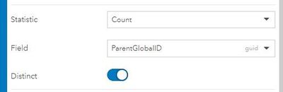

I am having an issue here - in my indicators counting the number of field work rounds, I can use the 'Distinct' button coupled with 'Field' set to ParentGlobalID, to only count the survey submissions, rather than the count including each of the repeats.
