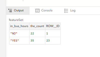

I think you might need a Data Expression. Unfortunately, datetime fields are always going to have a pesky date aspect, so 8:15 on Monday will look earlier than 7:15 on Tuesday.
You could easily display the in/out of business hours for a single item in a List or Table, but to aggregate the information, you'll need the time to behave like an actual field.
You could iterate over your features and calculate that for each, but fortunately, we can do this with GroupBy. This allows us to send a SQL expression to the feature service, where it will evaluate much faster, and it returns a FeatureSet, so we don't have the hassle of building our own.
Here's an example, using the hours 8:00 and 17:00 as my "business hours" limits.
// get your feature service
var fs = FeatureSetByPortalItem(
  Portal('https://www.arcgis.com'),
  'itemid of your service',
  0, // layer id
  ['objectid'],
  false
// sql expression to see if a value is between 08:00 and 17:00
var sql = `CASE
WHEN EXTRACT(HOUR FROM created_date) > 8 AND EXTRACT(HOUR FROM created_date) < 17 THEN 'YES'
ELSE 'NO'
END`
return GroupBy(
  fs,
  {name: 'in_bus_hours', expression: sql},
  {name: 'the_count', expression: '1', statistic: 'COUNT'}
- Josh Carlson
