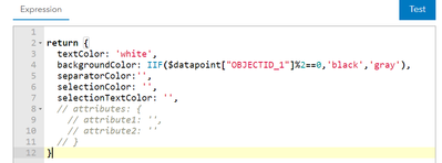

An expression like this should work under Advanced Formatting
IIF($datapoint["OBJECTID"]%2==0,'black','gray')

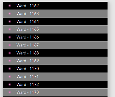

Olwyn_Bruce
Thank you!! Works like a charm.
