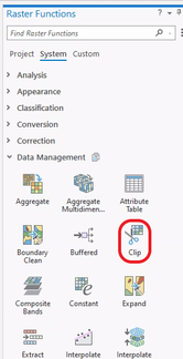

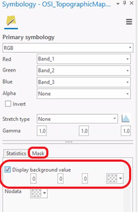

@CourtneyWatson if you're publishing from Pro, you can either set the 0,0,0 values to transparent in the symbology settings:
...or you can create a Clip Raster Function and clip your raster by a polygon feature.

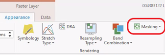

or you can Mask the black areas by a polygon feature
