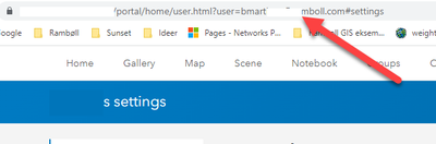

Thank you SzuNyiapTang Right now it's the classic dashboard, but could be anything really. What you are describing, is what I'm doing, but by hardcoding the email through Power Automate, I'll need 50 different links, one for each user. What I'm thinking of, is automatically add the ?email=[email protected]   and take the mail from the user that are logged in, just like when we look at a users info
