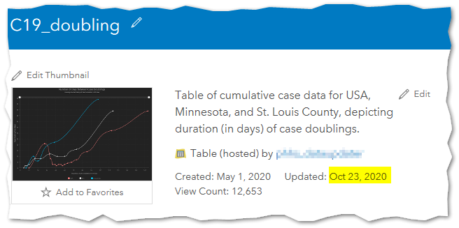

I think others have also mentioned that it would be super helpful to be able to simply point to the date the hosted feature layer was last updated:
