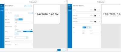

@EldertTeijema  I believe you should be able to accomplish what you want via an indicator. One option is to configure it something like what I've pasted below (the 'trick' is to never actually display the Value Field on the indicator). Another option will be to use Arcade (currently available in ArcGIS Dashboards Beta
