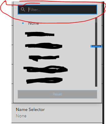

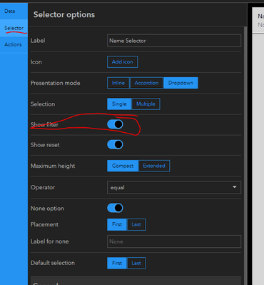

JeffMay2
If you toggle 'show filter' in the selector options for the Category selector, it will provide an input box the User can type in to.
AW_Grove
Hi @JeffMay2  - where do you see the show filter toggle? I am in the category selector and can't find it. Thank you!
JeffMay2
@AW_Grove , sorry for the late reply.
With the show filter option enabled, It will add a input box above you values.
