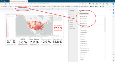

As an imperfect workaround, when I want to view a dashboard at multiple resolutions (to see how it gets affected), I use a variation of the workflow outlined in this video. In a nutshell, I have modified my browser's developer tools to include a handful of resolutions, and I switch between them  https://www.youtube.com/watch?v=zY0afqN6TOA
