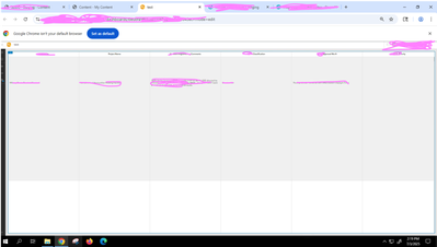

VictoriaDavis1
For example: enabling word wrap for a header (and changing the header height) here would allow room for more fields to show on the screen. I understand the details widget allows the ability to view several fields in on view, however it isnt ideal for selecting a few records and having them all show on the screen to do analysis of several fields, comparing and visualizing all on the same screen.
VictoriaDavis1
@Neal_t_k  i saw those posts but it unfortunately didn't work the same way for me, i appreciate the comment though!! i have my browser zoomed out to 50% to emphasize how silly it looks on our data. That made the individual horizontal rows a massive height. This text field has a length of 1000 in order to fit all the necessary data, which i believe is why it is like that. It'd be nice to be able to customize the height of the rows for that word wrap option.
Since that ^ didn't work. For the cell data, we went with limiting what is in view, and then hover to see the entire attribute.

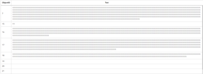

Neal_t_k
@VictoriaDavis1 That's weird behavior. Where I have word wrap implemented it only expands the applicable row and only to the length needed, not every row and not to the max allowed.
also fit column width to data may help in the example you have above.
As for the header I have no ideas on those.

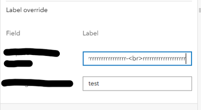

Neal_t_k
@VictoriaDavis1 Scratch that I have one idea for headers.  It would be a manual solution, but you can put <br> in labels for the header and it recognizes them.
VictoriaDavis1
GENIUS! that <br> works GREAT! THANKS!!!!!!!!!!!!!!! @Neal_t_k
