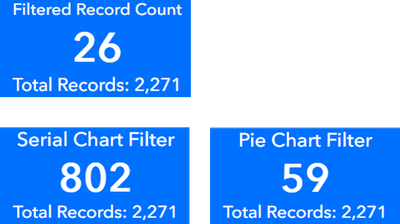

I agree that filters can cause confusion for users and that (at the very least) a Clear All Filters option would be a very nice addition to Dashboards Beta. One tip that may help is to add an Indicator to your dashboard that shows the record count returned by all the filters. Just add this Indicator as a target whenever you apply a filter. This way the user can at least see a filter is being applied to the data. You could also use a separate Indicator for each element that filters your data if required. That way you know exactly which elements are filtering the data.
Jamie.
