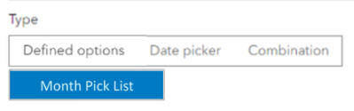

I am proposing a third option:
  • Month Pick List

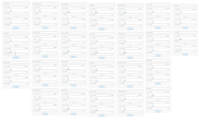

For quick analysis, date picker isn't always practical for quick comparisons between specific month ranges. Users must manually select each beginning and end date, and if they are just intending to review a full month range, this certainly is too precise of effort for the intended result.
For this reason, I've always used defined options.
Problem with Defined Options for Month List?
There's a lot of set up to build out the SQL date clauses. As time moves forward, the dates need to be redefined with new clauses. For multiple different month selectors, this implies significant setup per filter.

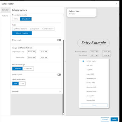

Solution — Month Pick List option:
Devise a third option for filtering dates that is month-specific. See the concept below in configurations to gain a rough idea of what it could look like.
Range Configuration Concept:
