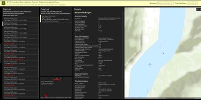

This is the dashboard using the published SDE database view for the Details pane because I could not get it to work properly using each of the related tables in it's own pane.

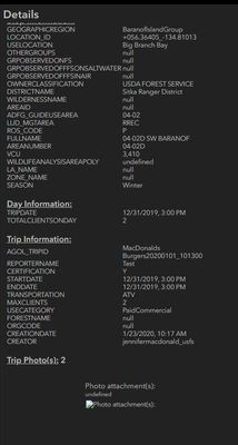

I am able to see that there are two photos for the selected record (Trip table TRIP_GUID is in the TRIP table and the PHOTOS table and the photo is in the attachments table linked to the Photos table on OBJECTID/REL_OBJECTID). But can not for the life of me get the photos to show up in the pane. At the bottom of the Details pane, there is some Arcade that can see there are two photos but they don't show there either (set up in the map Popup).
