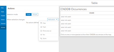

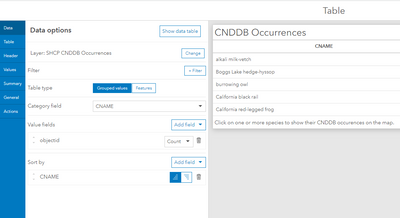

I currently only have the Filter action available because I'm displaying data as grouped values rather than as features (see the Table Type option below).
Changing the table type to Features exposes the rest of the actions, but that's not an acceptable solution for me because I have hundreds of features and need to group them by value.
I really would love to be able to flash and/or zoom to all the features in each group (some groups have only a few tiny features and they are nearly impossible to spot on the map). Obviously the Show pop-up action wouldn't work, but it's not immediately clear to me why it wouldn't be possible to apply the Flash, Pan, or Zoom action to the selected set of grouped features.
