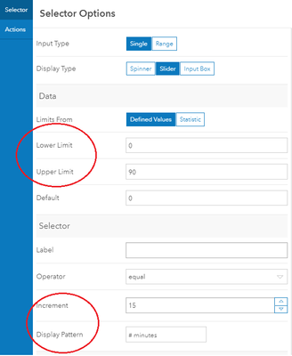

Situation: I want to display and filter travel times from multiple locations, using15, 30, and 45 min travel time layer.
Currently: The slider option changes in 1 min increments, when precision is set to 0.
Ideally: I should be able to set the increment to 15, so that when I move the slider it moves to only 15, 30, and 45. The drop-down option works this way, but I don't care for that style. With an increment option, I can set the ranges to match the analysis layer, whether tracking time, distance, or some other criteria.
Extra: Even better, would be an advanced option to set whatever stops I want. For example, if I'm using the slider to filter areas by median income, I could set the breaks at 10k, 25k, 50k, 100k.

@TysonM If I understand the idea correctly, I believe we already offer what you're asking. Let us know if not.

@patrickbThank you, I see the option in the current version of Dashboard. I should have clarified that I was using the Beta version, which still does not appear to support increments. If it will be a while before the Beta supports this feature, then I may have to redo this using the current version.
