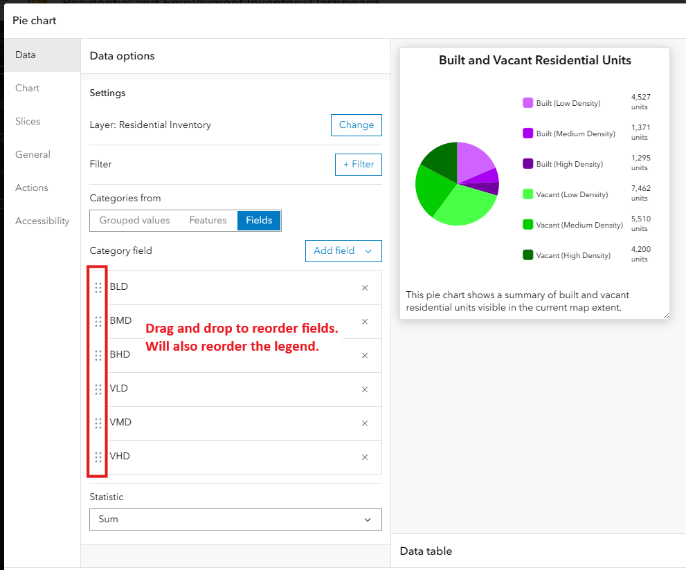

@patrickb is there a way to sort legends for a multi field pie chart in dashboards?
sarahc_WellingtonCounty
@GraceTortorici_ Not sure if you've already found this setting or not, but I noticed you can reorder the fields in the data tab of the pie chart settings. Reordering will update the legend order too.
