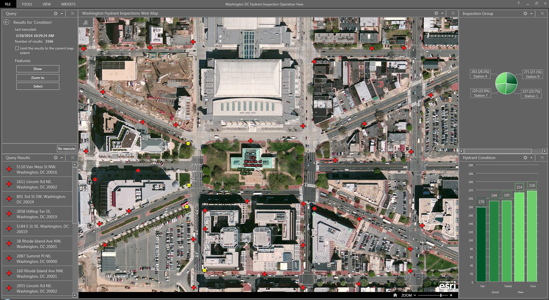

Below is an example of an operations dashboard for hydrants throughout Washington DC.

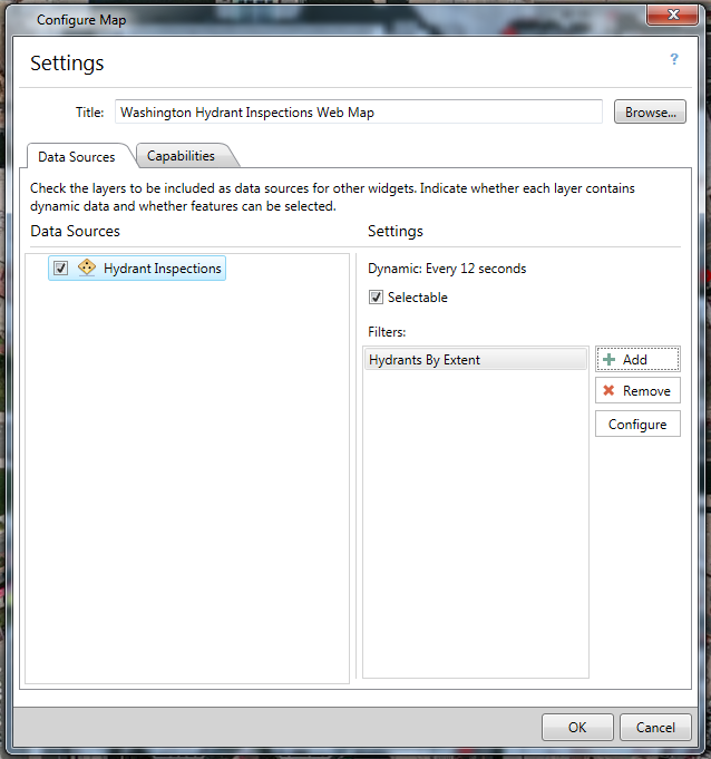

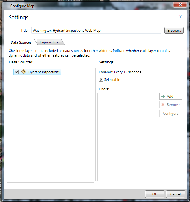

I want to add a Summary widget, but only report the summary of hydrants for the given map extent.  First thing I want to do is create a filter for the map widget.  Click the settings icon for the map widget and choose Configure:

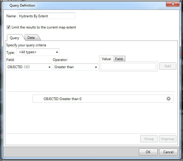

On the right, next to Filters, click 'Add'.  Specify a Name for the Query Definition, check the option 'Limit the results to the current map extent', and create a query where OBJECTID Greater than 0:
After clicking OK, you will have this filter listed:

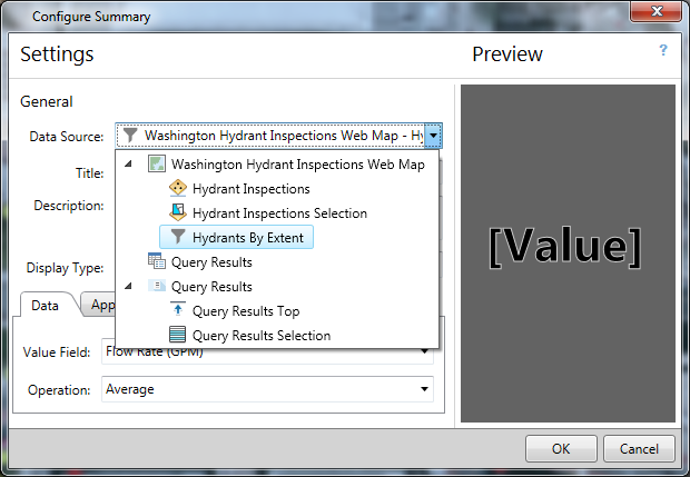

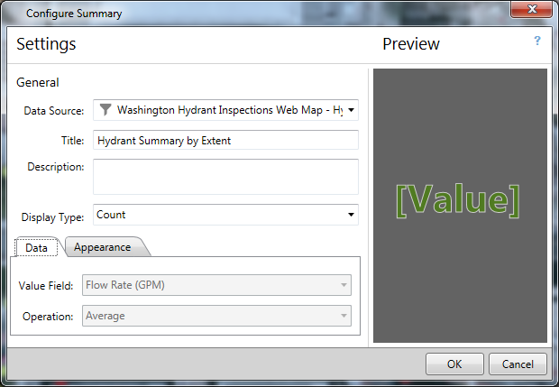

You can now create a widget and use this Filter.  In the below example, I am configuring the Summary widget to use this filter:

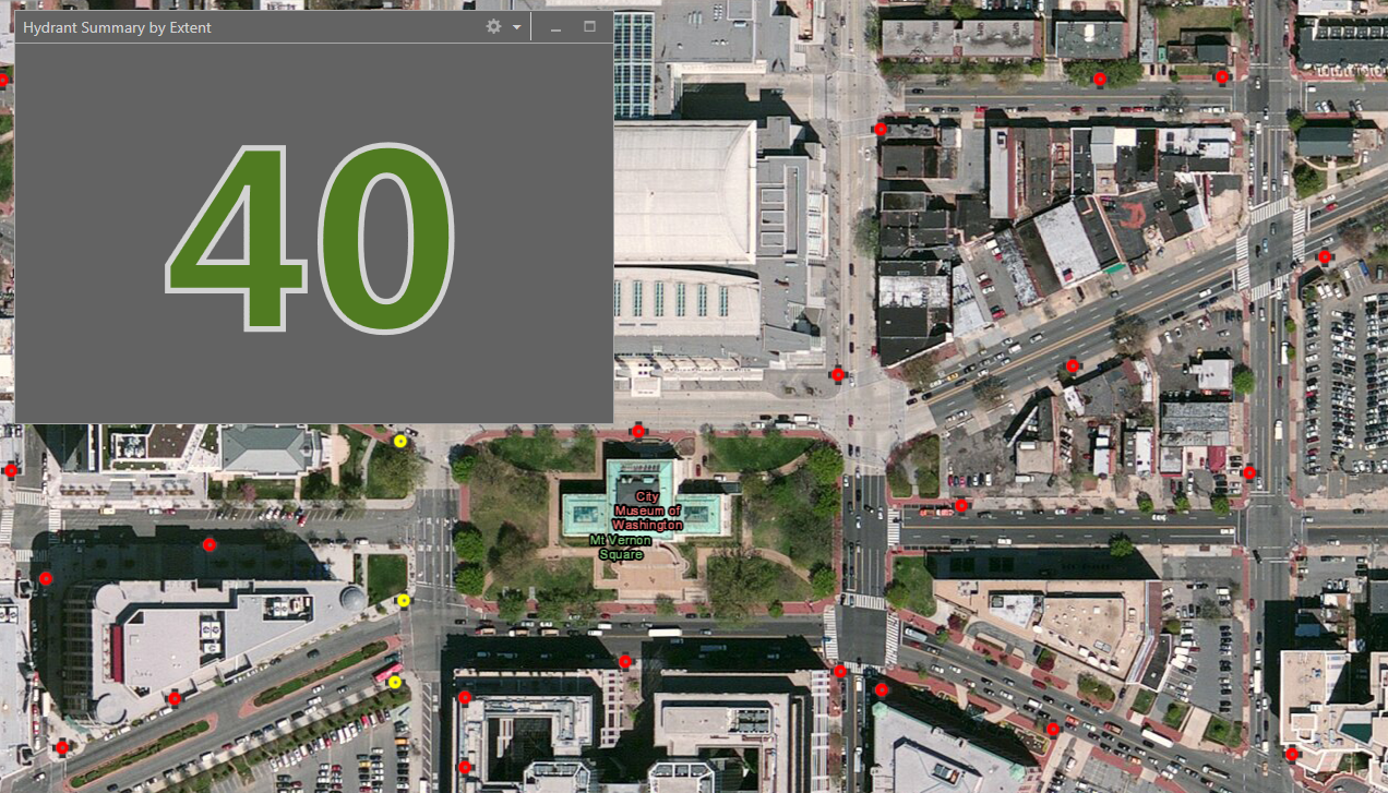

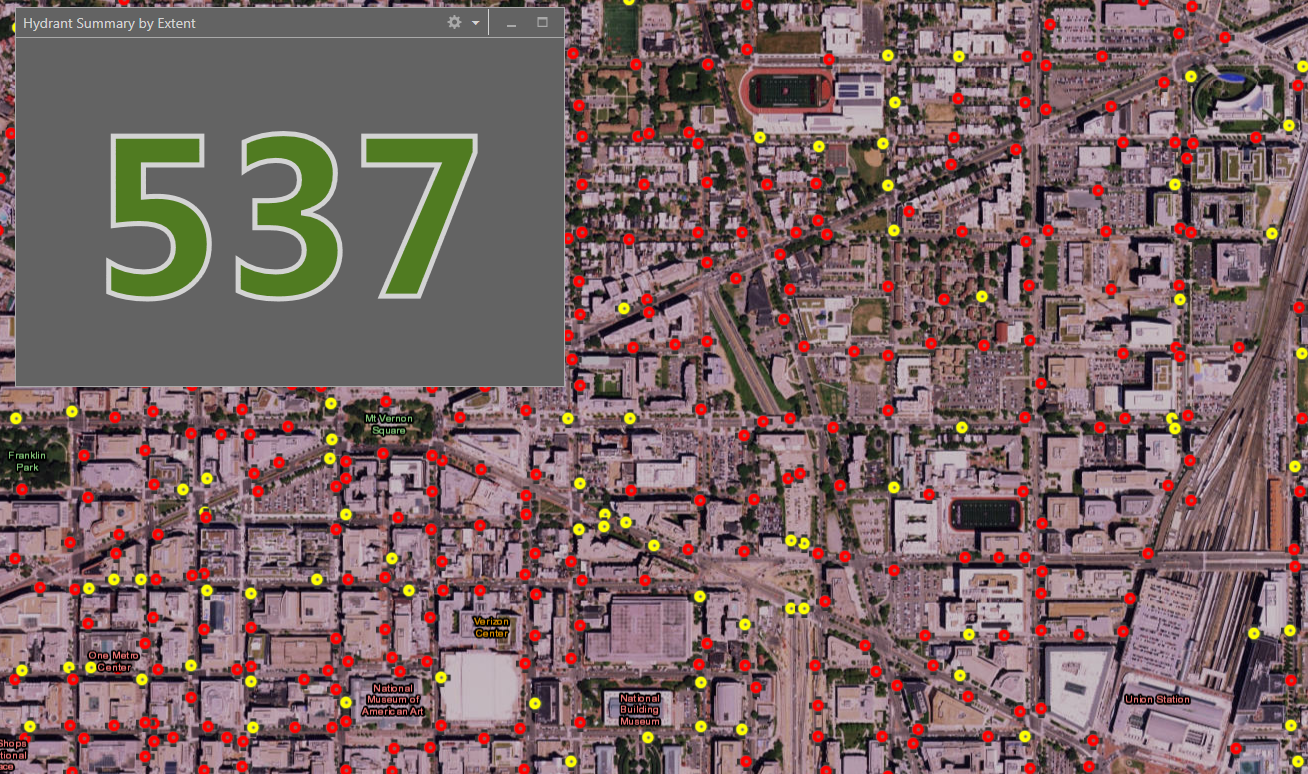

Now the Summary widget will update as the user zooms/pans around the map.  Ex:
