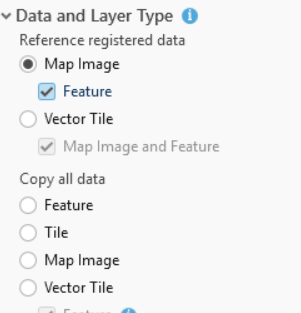

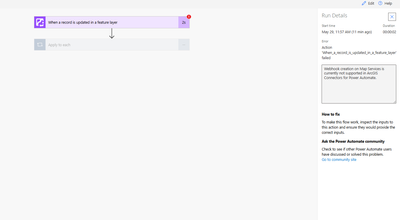

Am I understanding correctly that it's not possible to use the ArcGIS Connectors on non-hosted feature layers? I keep getting the error "Webhook creation on Map Services is currently not supported in ArcGIS Connectors for Power Automate." The data I'm trying to access is a feature layer in our Enterprise account published from our organization's federated server. The URL ends in .../FeatureServer/0.
If I can't use the ArcGIS Connectors in Power Automate, what other triggers can I use as a workaround? My goal is to automatically send an email whenever a feature's 'Condition' field dips below 4. The features are updated in Field Maps, but this particular field is only calculated weekly. I don't know much about Power Automate so I'm open to any suggestions. I've attached a screenshot of the feature layer's configuration, but I'd like to find a way to accomplish my goal without changing the configuration, if possible.

Thanks for your question. What version of ArcGIS Enterprise you are using? Here are a few pointers for using Power Automate and ArcGIS Connectors.
  • In General, Power Automate must be able to access the URL of the layer. Machine you are accessing should not be behind a firewall or an internal network.
  • To use any triggers (webhooks) in the ArcGIS for Power Automate connectors you must be the owner of the feature layer.
  • ArcGIS for Power Automate connectors currently don't support Webhooks with feature layers referenced from an enterprise geodatabase and on map services. Though this functionality is in current development pipeline and we are hoping to release it soon.

Does this mean that only hosted feature layers in an Enterprise can be used with Power Automate webhooks?
You can create webhooks on Hosted feature layers in ArcGIS Enterprise. This means when you publishing data to your enterprise from ArcGIS Pro, you are selecting `Copy all data` option. If you select `Reference registered data`  (meaning you are referencing a data from Enterprise geodatabase) web hooks created on resulting Feature layer are currently not supported.
Or does your bullet point only apply to feature layers and map services shared from Enterprise to ArcOnline?
I am not sure what you mean.
Can I use the Power Automate Connection for my Enterprise 11.3 in conjunction with the Power Automate Enterprise triggers that utilize webhooks such as "When a record is created in a feature layer" or "When a record is updated in a feature layer" with data published from an Enterprise geodatabase?
You can use all the triggers as long as it is not referencing registered data from in ArcGIS Enterprise.
