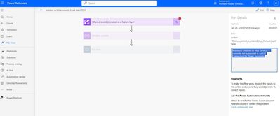

I'm on ArcGIS Enterprise 11.2 and am very new to power automate. Currently the flow I'd like to implement involves sending an email when a new point feature is created in a feature layer however the trigger never fires. I've confirmed that the webhook is being created on the feature layer I want to trigger the event. I've also confirmed that I can access data from the feature layer using the manual button and the get data action. I've tested this by trying to add new points in field maps, map viewer, and ArcGIS Pro but no matter what the trigger never fires.
I'm at a bit of a loss now as to what might be going on. Any help would be appreciated as I really want to leverage Power Automate for our business.

Hey, yes. The trigger needs to come from a hosted feature layer. So publish with "copy all data" and make sure editing is enabled.
