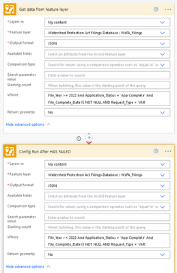

Hi @SeanKMcGinnis  -
This just results in another failure, unless I am setting it up incorrectly... I have 2 duplicate "Get Data from feature layer" connectors - the second is set to "configure run after has failed".
There are no results to query on many days so no results will be returned.
Even when I just change my "Apply to Each" to run after the "Get data from feature layer" has failed, the entire flow fails.
