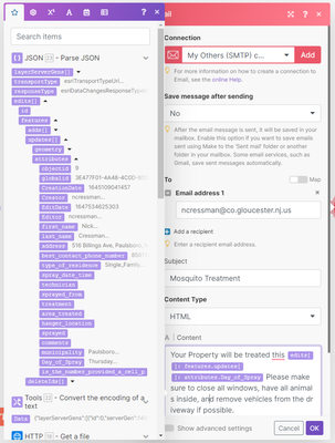

@Anonymous User I actually followed your post and completed it. My only question is how do you break out the fields like make. If you look at the image below I can pick what field i want in make to include in my email that I send. This is important as the day of the week assigned is what needs to go out in the notification and day of the week is a field in the layer.

Oh, when you are iterating over the features, I think you can use this expression to get a specific attribute:
item()['attributes']['someField']
 For dates, you'd want to format it:
addSeconds('1970-1-1',Div(item()['attributes']?['date'] ,1000),'yyyy-MM-dd')
 I haven't tested it but I think these should work.

This did work thanks for the help!
