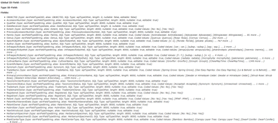

I was wondering if anyone would be able to help me with this issue. I am trying to create a flow to reach out to ESRI's REST API and grab the list of values for certain domain's in our feature layer.
I am not sure if it is possible, I am able to get the details of the feature layer through this but not the list of values for each domain.
I have attached a screen shot of the data I am trying to pull just in case.
Thank you to everyone in advance.

When I try to post this query I get the following message.
Error: Feature (ID: queryDomains) not found
Unable to retrieve feature.
I am sending the get request to this full URL here:
services9.arcgis.com/KTBF4553OvjgRYTW/arcgis/rest/services/PlantCenter2021/FeatureServer/0/queryDomains
Again thank you for taking time to read this and give me a point in the right directions.

GregKent1170
Sean,
Thank you so so much! That worked for me! The last question I have is can I filter the request to just pull data from a single field from within that layer?
For instance within that layer I have a field that is called "Genus" and there is 81 entries within that.
Here is a peak at the view page for that layer and some of the fields. If I am able to just pull the entries for a single field I will be able to pull off what I need!
You have been really awesome and  helpful I really appreciate this!
