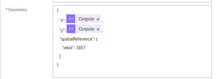

I am having two issues with the "Create a record in a feature layer" action in Power Automate. One being that the datetime isn't transferring into the feature layer. What format does it need to be converted to for Esri?
Secondly, I am trying to plot by coordinates but the points are being thrown to null island. Is the geometry input incorrect? The "outputs" next to x and y are the coordinate fields.

This is how I have the geometry field set up for the inputs when I am creating a feature. Though I definitely went the more, copy from an example somewhere than having a complete understanding of all of it.
What coordinate system are your X and Y values in?

Thanks for your response! All of the information, including the coordinates are being scraped from an email and currently dropped into an Excel file, but I am trying to publish the information into the feature layer rather than having to export the excel data and append to a feature layer. The above looks like you might be pulling geometry from an existing layer, my input values are just the lat/long pulled from the email body as text. So maybe it is a formatting issue?

I am indeed pulling from an existing layer at this point in time. I think the issue as Pavel outlines below is likely that the coordinates you are providing do not match the spatial reference you are giving? Do you know what coordinate system your coordinates are in?
Have you verified looking at the run of your flow what the values being extracted from the email text into these variables actually are?

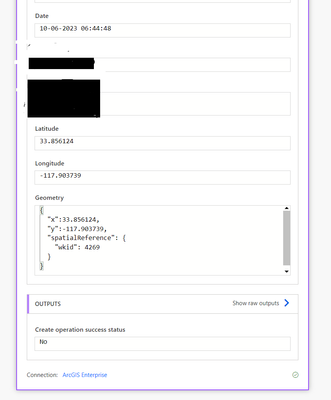

The screen grab below shows the output of the "Create a record in a feature layer" action. The coordinates are populating in the table but not plotting, so I feel like I am missing a step here. I did update the coordinate system after confirming.

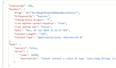

The datetime also shows here but does not show in the feature layer. The error in the "raw outputs" is as follows:
"description": "Cannot convert a value of type 'java.lang.String' to 'TIMESTAMP'."
I hope this helps to clarify! Thank you both for your assistance! @Pavel148
