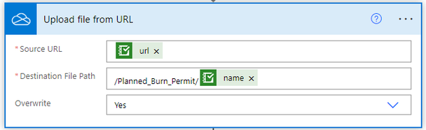

Can you show us your Upload file from URL settings? I have a similar flow and below are my settings. This is working just fine for me
MariusVerdes
Hi @DominicRobergeIADOT ,
I have similar settings as you. The only difference is that I am using a custom connector since I want this to work based on our ArcGIS Enterprise 11.1. I saw a few tutorials and this is how I built the flow. For the URL and name dynamics content I used the " x of the first result file".
