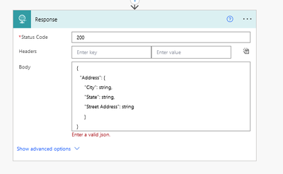

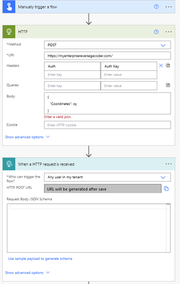

The main idea would be to use the HTTP (Premium) connector to send a POST request out to your Enterprise Reverse Geocoder, and then when the response is received and captured by the "When a HTTP request is received" and then my a Response connector, this is an example of what it would look like here:
This is the gist here, test data within to provide a structure. Let me know if you need anything further!
