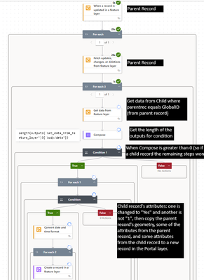

That said, this does sound like a little backwards from what I would expect though. Your environment and specific workflow is likely different from what I am envisioning, but this would be my first instinct:
1) Watch parent layer for changes, and trigger flow accordingly (thought here being that the child/related table should never be updated without the parent).
2 - Option A) Use a value from the parent table in a condition (similar to what you have) to conditionally run Get data from feature layer. If the condition is true, then this part should run as data should be there.
2 - Option B) Simply use a Get data from feature layer action on its own (Option A is best, if possible, as it avoids unessesary calls to Portal). Next, use a compose with something like length(outputs('Get_data_from_feature_layer')?['body/data']) to check if any records were retrieved (value returned will be an integer), then use this output in a condition.
In both cases for Get data from feature layer, you'd do something like Query by field = ParentRowID (from the Child) with Search value = UniqueRowID (from the Parent). You can also toss in a Where clause if needed. Example:
As I said, Esri connectors like to fail gracefully. So even if you go with Option B and no records are returned, this wouldn't fail (at least at this step).

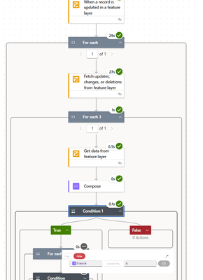

I tried creating another flow starting with listening to changes in the parent record (because I agree with your theory that a child record wouldn't be updated without the parent), but again, when I click on the run to see what happened, sometimes it shows as expected (look, though, at the ! still displayed next to the Condition result, even though it says "False"):
