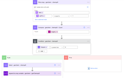

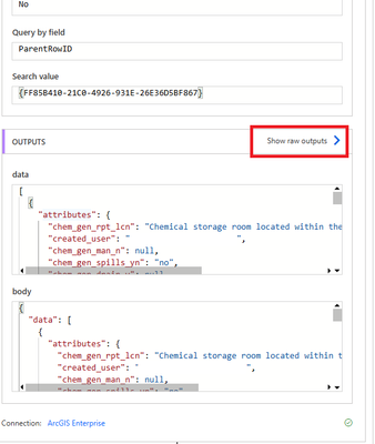

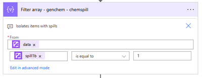

It really depends on how you are getting your data. But most actions have an "Inputs" and "Outputs" section. The "Outputs" is what you would be looking for because those Outputs are what you use in your subsequent steps. Normally, there is a "Show raw outputs" button that makes this extra easy.
For example, in the flow I am currently building, I am using Esri's Enterprise "Get data from feature layer" action. If I view the outputs, I get this (note that I deleted everything out of "headers" as well as some personal information from the "created_user" fields):
    "statusCode": 200,
    "headers": {},
    "body": {
        "data": [
                "attributes": {
                    "chem_gen_rpt_lcn": "Chemical storage room located within the north central portion of the building. ",
                    "created_user": "",
                    "chem_gen_man_n": null,
                    "chem_gen_spills_yn": "no",
                    "chem_gen_drain_y": null,
                    "parentrowid": "{}",
                    "globalid": "{}",
                    "chem_gen_drain_yn": "no",
                    "chem_gen_spills_y": null,
                    "chem_gen_rpt_name": "Chromic acid",
                    "last_edited_user": "",
                    "chem_gen_rpt_con": "good",
                    "chem_gen_man_yn": "yes",
                    "spill1b": 0,
                    "last_edited_date": 1779291698703,
                    "created_date": 1779291698703,
                    "objectid": 1
                "attributes": {
                    "chem_gen_rpt_lcn": "Chemical storage room within north central portion of the Site Building. ",
                    "created_user": "",
                    "parentrowid": "{FF85B410-21C0-4926-931E-26E36D5BF867}",
                    "globalid": "{B3E401F1-C71F-4354-B715-0E9D37808D89}",
                    "chem_gen_rpt_name": "Nitric acid",
                    "spill1b": 0,
                    "objectid": 2
With this schema, I can now do two things:
  1. I can reliably build my compose action to pull out a specific piece of data. E.g., I want to use "spill1b" in a condition. I would build it as either body('Get data from feature layer')?['data']?[0]?['attributes']?['chem_gen_rpt_lcn'] if I wanted the first item from the array, or item()?['attributes']?['spill1b'] if I was using a Filter array step to get all items where "spill1b" was equal to 1
  2. Check my outputs/schema to correct an error.
In your case, you are getting inconsistent results from your workflows. That points to the issue most likely being the wrong information being extracted, or the correct information being extracted but used incorrectly. Thus, putting your specific outputs into a Compose action will allow you to verify on the fly what went wrong. E.g., If you expect an attribute to be "Yes" but it is in fact "yes", that would be a problem.
Again, this is the workflow I am currently building. You can better see this logic in action:
* Also, small disclaimer. I tend to not use the "New designer" personally. I have found that it has (or maybe had?) many bugs which have caused me many problems in the past. I also find the classic designer is considerably better at using available screen realisatate, and many of my flows can get quite long.

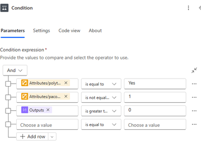

This issue is intermittent. There are still errors in my Condition, and I can't figure out why. Here is my Compose input:
And my Condition: (the Outputs is: outputs('Compose') )

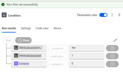

But I still get errors and the Flow says it's successful!
Is there anything I can do? I have to go into each run, check if it actually was successful, and manually fix it if it didn't.

Do you have a screenshot of the errors somewhere? Esri connections tend to "fail gracefully". That is, they will fail, dump all the failure data into an "Error" table, then mark the execution as a "Success" because they "successfully failed". If you expend the Esri step though, you will see the "Error" table and get a better idea of what went wrong.
From these screen shots, everything appears to be correct. The only change I'd personally make is put those other two attributes into their own "Compose" and then reference those Composes in the "Condition".
