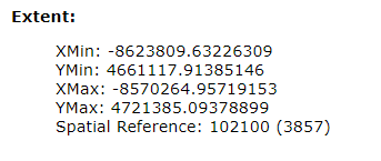

  • The geometry for FS1 gets recorded in AGOL as 3857. This is shown in the 'Extent' values for the feature service:

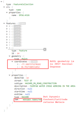

  • Using the dynamic content functions within ArcGIS for MS Power Automate Connector to pull 'lat' or 'long' values for FS1 or 2 I'm getting Meters values back. This may be expected behaviour, but...
  • If I query the (geo)JSON and obtain the full feature, not just what the ArcGIS for MS Power Automate Connector returns, I can see that the feature's coordinates as recorded in AGOL are listed in Decimal Degrees:
 Therefore:
  1. Is it expected behaviour that using the dynamic content functions within ArcGIS for MS Power Automate Connector to pull 'lat' or 'long' values returns them in the units specified within the feature service?
  2. How do I actually get the values used by AGOL (decimal degrees) using the ArcGIS for MS Power Automate Connector to pull 'lat' or 'long' functions? I'm presently having to query the whole features geoJSON and parse out the {coordinates} shown above.

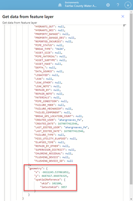

Thanks @RudolfdeMunnik I tried the "Get Data from Feature" tool using the below flow:
  • Detect new features in FS1
  • Fetch those features
  • For each new feature "get data from feature" (including the geometry)
However, the raw output from the "get data from feature" still returns geometry as Meters. In my mind the dynamic content 'geometry', 'Lat' or 'Lon' should be in WKID 3857 decimal degrees as recorded in AGOL.
