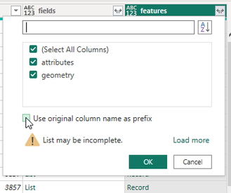

Step 4: Expand features
First expand the "features" column by clicking on the "expand" icon
Select "Expand to New Rows"
Step 5: Expand features
Un-tick "Use original....."

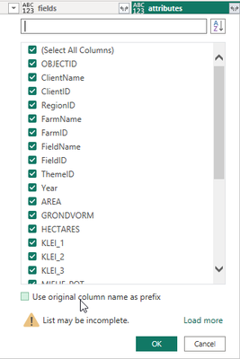

Step 6: Expand attributes
After expanding - scroll to the last "geometry column"

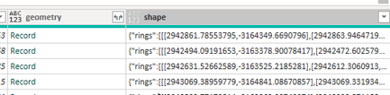

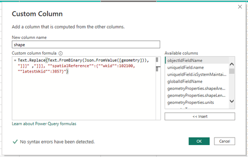

Step 7: Add custom column to format EsriJSON geometry and add Spatial reference to each record
The critical step is to add a "Custom" column from the Power Query "Add Column" main menu
  • Provide a column name e.g. "shape"
  • Add the following syntax after the "=" sign Text.Replace(Text.FromBinary(Json.FromValue([geometry])), "]]]" ,"]]], ""spatialReference"":{""wkid"":102100,""latestWkid"":3857}")
  • Text.FromBinary will create a single string from the nested rings
  • Text.Replace will add the Spatial Reference after each records - Note the correct Spatial Reference

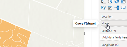

Test:
  • Add the ArcGIS for Power BI visualizer
  • Move the "shape" column to the Location fieldwell
  • Check if geometries are drawn correctly

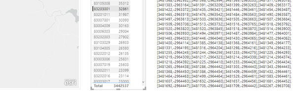

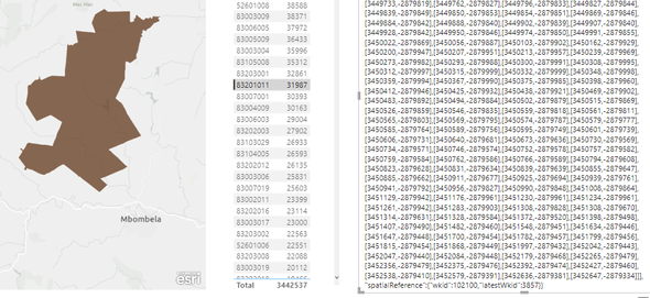

Step 8 (optional): Add geometry length field to view large geometries over 32 000 characters
You can add an additional "Custom Column" to count the Length of the geometry characters. This is to see which records exceed the 32 000 character limit of Power BI. You can then identify missing geometries.
Geometries under 32 000 characters will have the "Spatial Reference" at the end - see sample below
Geometries above 32 000 characters will not end correctly and therefore not appear on the map.

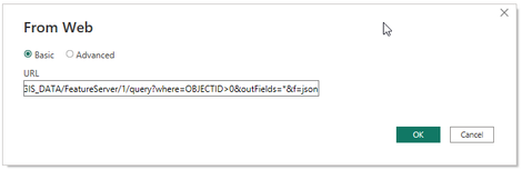

RudolfdeMunnik
@NasreddineD   Apologies for replying only now. For some reason the URL that i copied in Step 1 did not copy correctly. So i created a screenshot of the URL. See below.
I hope this helps
