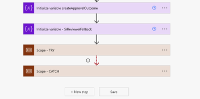

As I've already mentioned, scopes. You want to put your entire flow into one scope, and your error handling into a second scope. The only exceptions being: 1) Initialize Variable cannot be added to a scope (super annoying), and 2) Flow Trigger (this one makes more sense).
Nomenclature
This type of setup is normally referred to as "Try" and "Catch", where Try is your workflow, and Catch is your error handling.
Terminate
When you do this type of setup, you need to guide Power Automate a little. When your error handling executes successfully (as it should), your flow will actually register as a success. This makes looking at your flows in Power Automate annoying. To solve this, always ensure the final step of your Catch is a "Terminate" (set to either Fail or Cancelled depending on your needs -- I go with Fail because I use Cancelled for other things).

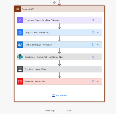

What Should Go Into a Catch?
It really depends on your needs. What you see above is a relatively "normal" Catch that I use. In fact, I probably have a good couple hundred flows with this general set-up.
  • Compose - This calculates and formats the difference in time between the start of my flow and this point in the flow. This gives me a "flow run duration" which can help me triage my Inbox at a glance. If you are curious, this is the formula I am using:
    dateDifference(variables('flowStart'), formatDateTime(utcNow(), 'yyyy-MM-dd HH:mm'))
  • Delay - This ensures that I don't create a backlog. Basically, when there is a failure early on in a flow, there is a chance that it resets so quickly that it ends up being the next thing to be processed. If there are a bunch of things needing to be processed, this can create a backlog. I don't always use a delay, but this flow in particular is trigged at least 600 times per day, so delays are a real concern.
  • Send email - this sends me an email letting me know that there is an issue. This is a key component to the Catch, and I go into it more below
  • Update Item - All my flows run in two parts: Part 1 grabs items from my Esri Portal and dumps them into SharePoint (aka my "Router"), and Part 2 sequentially grabs items from my Router for processing. This step re-sets the item in the Router so if can be re-processed. Basically, I try to be as hands-off as possible in my workflows. I have better things to do with my time.
  • Condition - I can end up with 4-5 of these. These just delete items from databases if my flow got that far. Basically, when something goes wrong, I get rid of or reset the additions it made, or else I'd end up with duplicate data when the flow re-runs.
  • Terminate - Another key component to the Catch. You need this.

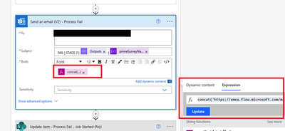

Error Email Contents
When something goes wrong, you will want to go to that flow to assess the problem and potentially make a correction. Add this to the email (as an expression):
concat('https://emea.flow.microsoft.com/manage/environments/', workflow()['tags']['environmentName'], '/flows/', workflow()['name'], '/runs/', workflow()['run']['name'])
 Here is what it looks like in the flow:
You can pretty it up and add more content if you want. But this is the absolute minimum you need.

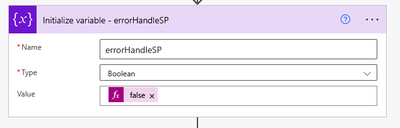

Step 1: Initialize Variable
Just make a boolean and set it to false (technically not required to set it to false, but it helps keep things simple for future you).

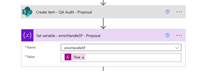

Step 2: Set Variable
Do this immediately after the thing you are going to reset. In this example, I set if after my SharePoint Create Item.

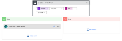

Step 3: Condition within the Catch
The condition ensures you don't try to reset something that doesn't need to be reset. As simple as that.

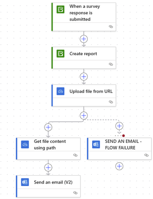

@abureaux It is very obvious that you are way more advanced compare to me and your knowledge super-seeds me 10-fold and your flow(s) and process(s) are most likely way more complexed compared to my simple Survey123 report creation and e-mail flows.
With that said, I went very basic and elementary in my flow(s) and just created a parallel branch with the "Run After" settings of successful or failed. Yeah, no duh ah?
One of the key factors that leads to a failed flow in Power Automate for me is when there is an ESRI outage affecting AGOL and Hosted Feature Layers (something that those above me that rely on these reports do not quite understand). If there is an unknown factor causing an interruption with AGOL and the feature layers that power the Survey123 process, I have a way of being notified instantly.
Perhaps someone else that shares my limited knowledge of Power Automate and coding, could also find this helpful.

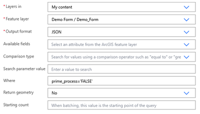

  3. In your flow, use the Arcgis "Get data from feature layer" connector, set Output format to "JSON", and the Where clause to something like prime_process='FALSE'
