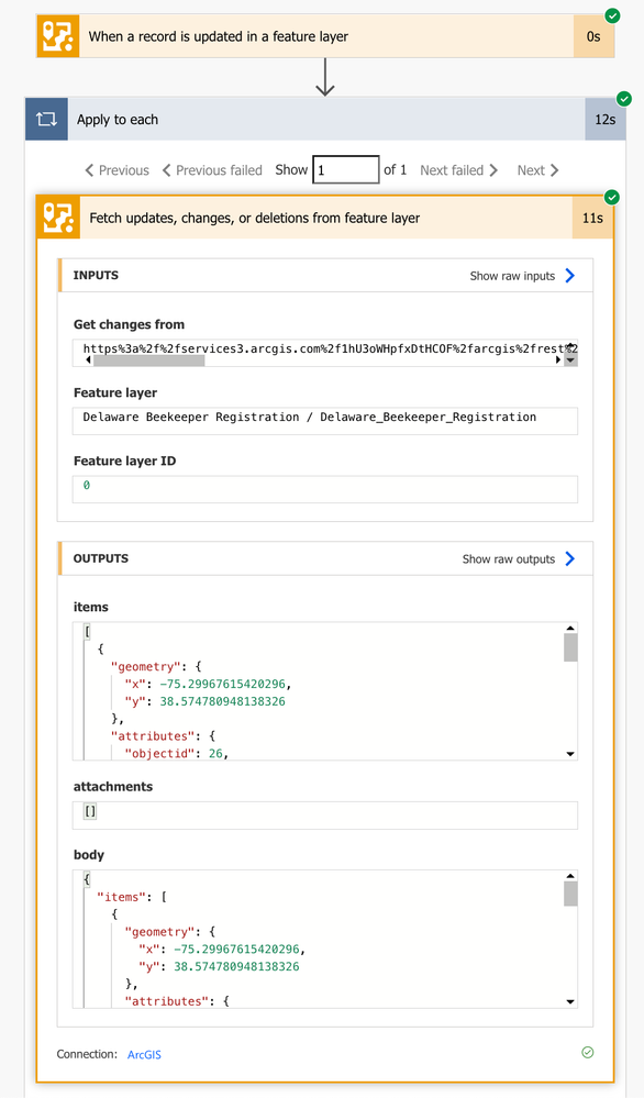

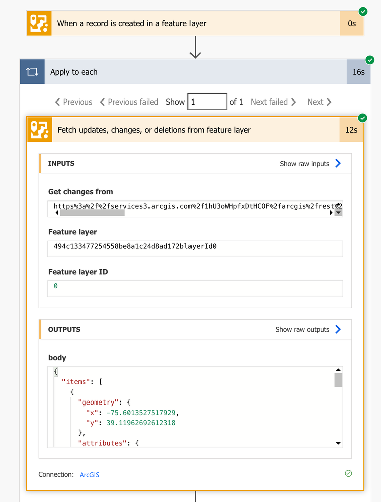

@KevinMantels & @GIS_Admin,
I just tested it with a create and update triggers and was not able to recreate the error you are encountering. Could you share a screen shot or an export of the flow you are having the issue with?
Screen Shot 2022-12-02 at 7.34.41 AM.pngScreen Shot 2022-12-02 at 7.34.41 AM.png
Screen Shot 2022-12-02 at 7.35.35 AM.pngScreen Shot 2022-12-02 at 7.35.35 AM.png

GIS_Admin
@SeanKMcGinnis I attached screen shots as a part of this original post. Do you need something else?

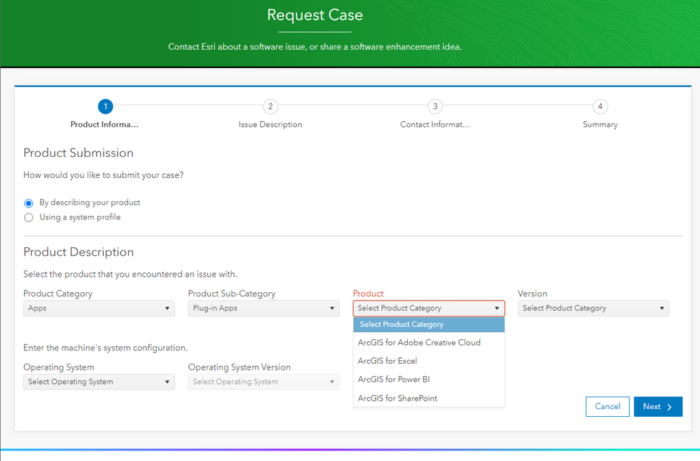

KevinMantels
@SeanKMcGinnis, thanks for the suggestion and sorry for the delayed response.  Is there a particular place I should submit a ticket?  I went to the "Request Case" page and reviewed most of the product category and subcategory options but there doesn't appear to be an option for Power Automate.  I just want to make sure I submit my ticket to the right place.
Request Case OptionsRequest Case Options
SeanKMcGinnis
@KevinMantels - interesting that it is not there. Log it with Power BI, it is the same team that supports Power Automate.
