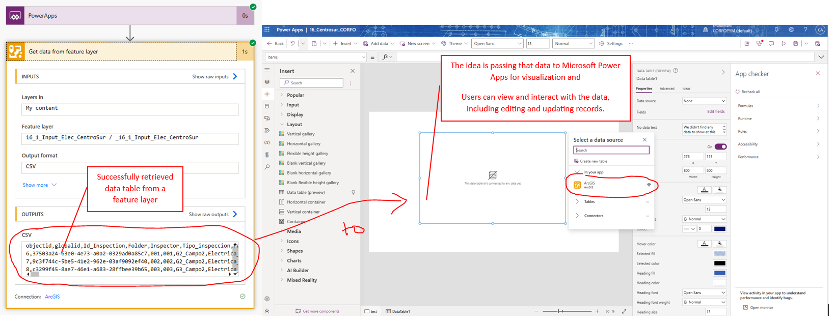

In Power Automate, I successfully retrieved the data table from a feature layer (image below).
Now, I want to display that data in Microsoft Power Apps (or another tool) where users can update an existing record in the feature layer.
Desired workflow:
1. The data table from the feature layer is retrieved in Power Automate.
2. The data is passed to Microsoft Power Apps (or another tool) for visualization.
3. Users can view and interact with the data, including editing and updating records.
4. Any changes made in Power Apps are reflected in the feature layer, ensuring data synchronization.

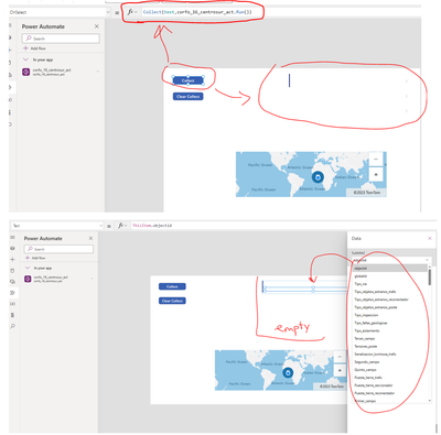

I have used Power Automate with the ArcGIS Connector to fetch data from ArcGIS (successfully), then used HTTP Response (I think the Response Body JSON Schema is misconfigured), but the flow test is still successful. (see image)
In PowerApps, I have created a Collect function on a button to display the data in a gallery. The column headers are visible, but the data is not appearing. (see image)
Help Please...
