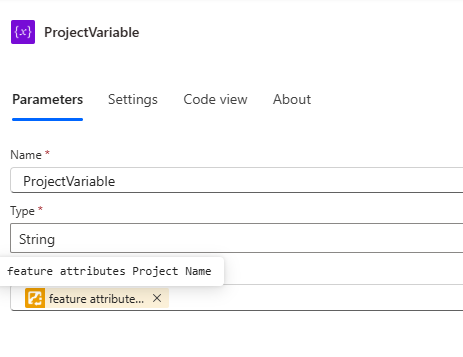

Here's my workflow. This uses the premium level ArcGIS connection. I used the When a Survey Response is Submitted as the trigger and the "Get Coded Value Domains from Feature Layer as an action. I then added the Initialize Variable action with the type set to String and value dynamic content pointing to the Project Name field from When a Survey Response is Submitted. I gave the variable a name of Project Value, which is what you will look for in Dynamic Content later on.
