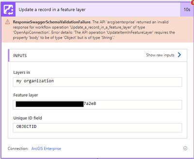

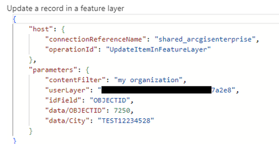

Update a record in a feature layer isn't working. It gives me the error:
ResponseSwaggerSchemaValidationFailure. The API 'arcgisenterprise' returned an invalid response for workflow operation 'Update_a_record_in_a_feature_layer' of type 'OpenApiConnection'. Error details: 'The API operation 'UpdateItemInFeatureLayer' requires the property 'body' to be of type 'Object' but is of type 'String'.'
Is this a bug or am I missing something?

Hi! I am running into this exact issue. Were you able to resolve this?
