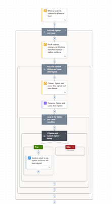

Yes, initial testing today and shown it to work. I'm working off a feature layer with over 250 fields and around 300 rows. Sometimes the flows can break if there is too much data for the trigger to filter, so many be worth, if you have a large amount of data, to filter down using the 'Get data from feature layer" action, and using the available fields and where function.
In order for the date and time function to work, there are a few things that need to happen.
1. You need 3 loops after the trigger. The first being to fetch updates, changes etc from the 'When record is updated' trigger.
2. A loop immediately after the fetch updates which will be used to convert the date and time field, since Power Automate can't read feature layer fields as date and time. Then within that loop, you need to convert the time into date only using compose. The function loops like this:
formatDateTime(outputs('Convert_Option_and_Lease_date_signed_and_time_format')?['body/stringTime'], 'yyyy-MM-dd')
3. The final loop for the conditions. In this case, I'm only interested where Option and Lease is Signed and the Signing date is today:
  "type": "If",
  "expression": {
    "and": [
        "equals": [
          "@items('Loop_in_for_Option_and_Lease_condition')?['Attributes/OptionandLeaseStatus']",
          "Signed"
        "equals": [
          "@outputs('Compose_Option_and_Lease_Date_signed')",
          "@utcNow('yyyy-MM-dd')"
For the testing of "today", you would have feature being "compose outputs" is equal to
utcNow('yyyy-MM-dd'). It's important to have the utcNow converted to just show date, otherwise it will use time as well and cause the condition to see if the compose date matches the now date and time, which will cause the flow to fail.
Other than that, I can't see any other work around until there is the ability to have an action to only return the changed attribute. There is a potential work around, without the need to have a date field associated with the change field, but that involves having Power Automate access the change log, produce the original data and changed data fields and comparing.
Hope this helps.
