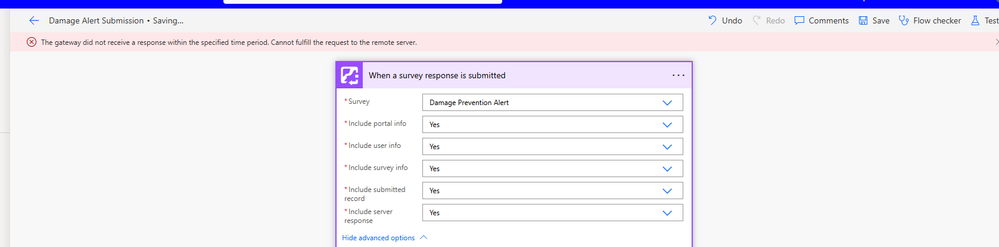

Recently, we've been running into an issue with webhooks not being automatically created by Power Automate in our ArcGIS Enterprise instance. We are using the "when a survey response is submitted" connector, and for our old flows, the Power Automate flow automatically creates the webhook in the Survey123 webhook settings.
However, as of last week, Power Automate has not been able to create any new webhooks in our surveys. So only our old flows work.
I tested with Integromat (Make) and it works, but the reason it works is because with the Integromat flow, is that you are manually creating the webhook entry in the Survey123 settings page. Screenshot 2024-12-09 114237.png
Any idea what this could be, as nothing on our end seems to have changed to start causing this issue all of a sudden.
