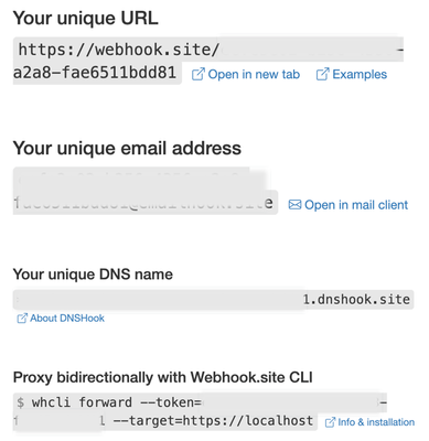

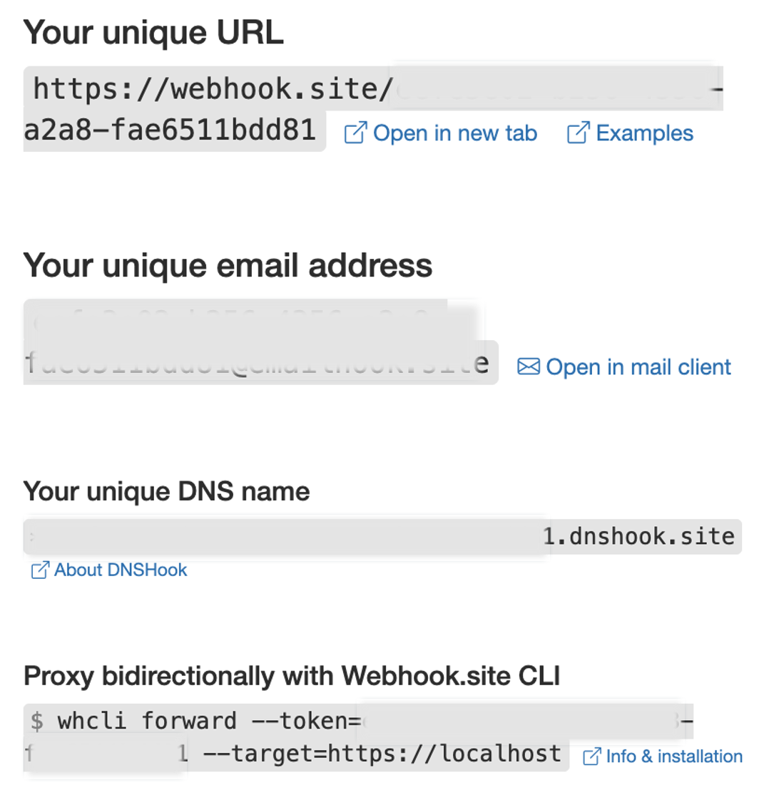

After setting up your Webhook.site profile (or using the free capability), they will provide you with a URL, an email address, as well as DNS and proxy CLI resources. In this scenario for testing feature service webhooks – we will be using the ‘Your unique URL.’

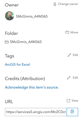

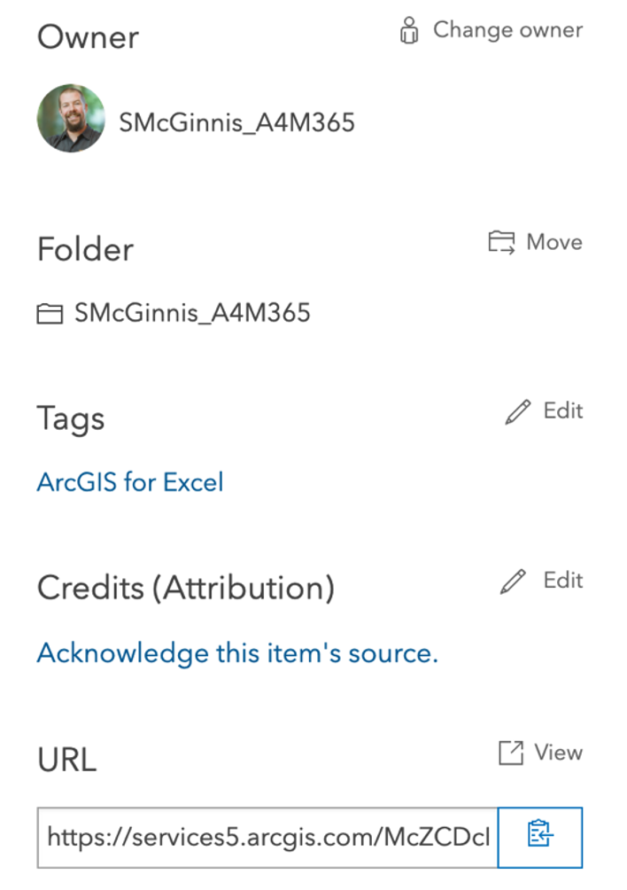

Now that you have the URL, we need to attach it to the feature layer to test whether the webhook is firing or not. Start on the item details page scroll to the service URL and click the ‘View’ icon.

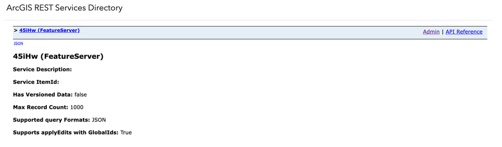

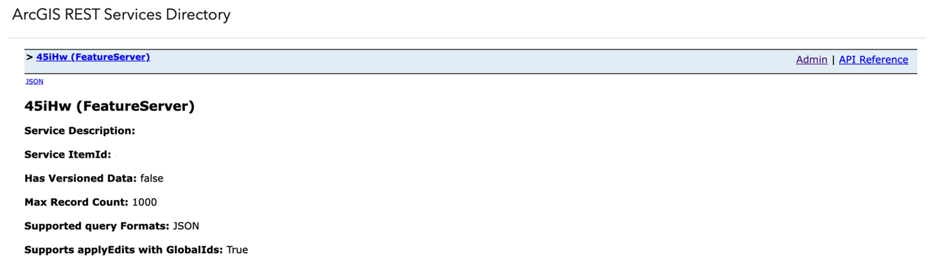

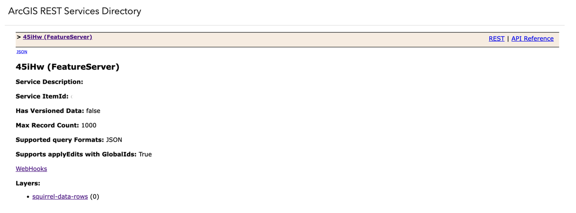

From the Services Directory page, click the ‘Admin’ link in the top right corner.
On the Admin page, click the ‘WebHooks’ link.

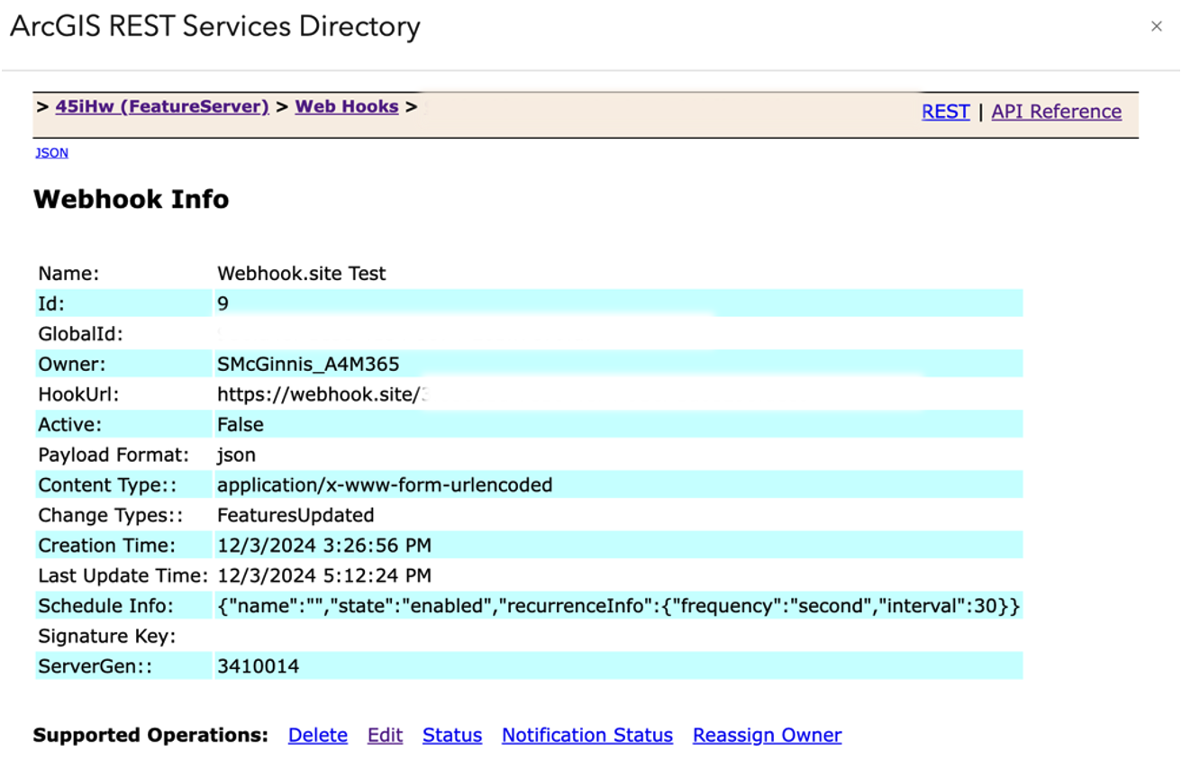

From the webhook page you’ll see all the webhooks associated with the feature service. To begin our testing and troubleshooting, we will need to create a new webhook with the URL provided from Webhook.site. This will help us to test whether the webhook is firing or if there is a problem in the Power Automate flow. Check the Webhooks documentation for a description and example usage of creating a webhook manually. When it is created your page will look similar to the image below.

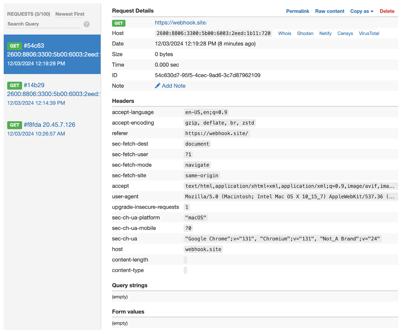

With this wired up, you can now begin testing to see if the webhooks are firing. When the appropriate event is done against the feature service, the page will show that the webhook has fired and is working as expected.
