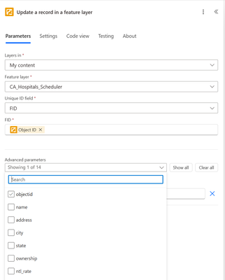

These actions will take Array of Features as their input. Notice the difference between Update a record in a feature layer Inputs vs Update records in a feature layer (batch)

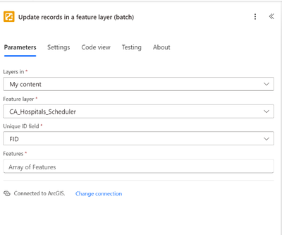

@ckellow Thanks for your question. I think maybe the example JSON isn't clear enough to understand this, hope following will clarify that.
In the Power Automate form for the action e.g. `Update records in a feature layer (batch)` requires you to choose the layer and the unique id field for that layer. According to the layer I am using in the screenshot above it it is `FID`. This is used to identify which features this batch action is going to edit and not the geometry. This means the attributes json must have the uniqueID field as a key value pair.
If it is a hosted feature layer then Unique id field is auto generated which could be FID/ObjectID or  GlobalID. In the JSON below I am editing the features with FID 1 and whatever the attributes/geometry I need to update.
    "attributes": {
      "FID": 1,
      "objectid": 1,
      "name": "REDLANDS COMMUNITY HOSPITAL",
      "address": "350 TERRACINA BLVD",
      "city": "REDLANDS",
      "state": "CA",
      "zip": 92373,
      "ownership": "Government",
      "ntl_rate": "No Different than Natl Rate",
      "mortreadmi": 20.7,
      "total": 52,
      "latitude": 34.03667703,
      "longitude": -117.2038564,
      "admissiond": 1436572800000,
      "GlobalID": "f822cf31-60d3-426d-8589-1c1486b19739"
    "geometry": {
      "x": -13047073.613499999,
      "y": 4033727.9189999998
