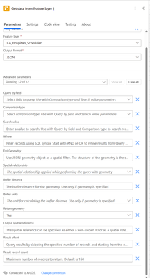

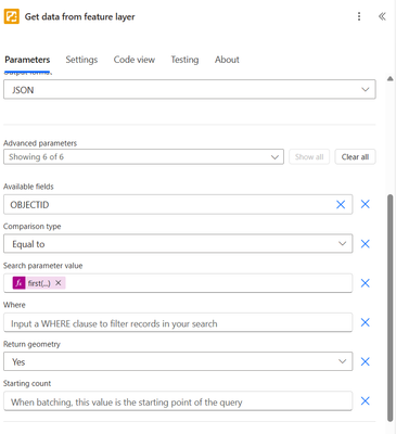

The user interface for the “Get Data from Feature Layer” action has a revised options and placeholders to let you know what combination of options to use. In the older version of this action, it was difficult to interpret what is possible without glancing at the documentation.
The “Available Fields” option has been renamed to “Query by field” this matches the Query Endpoint of the ArcGIS REST API. The placeholder text will let you know what other parameters you need.
Older interface
New Interface

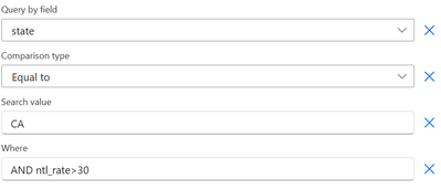

You can now combine any set of necessary parameters. E.g “Query by Field” (and its related “Comparison Type” and “Search Value” parameters) with a “Where” clause. This enables more powerful and granular queries, giving you the flexibility to filter records using field-based criteria alongside complex SQL expressions in your “Where” clause.
Here is an example:

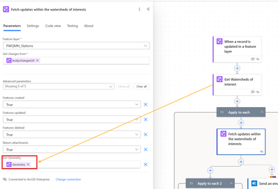

Building on the enhanced geospatial querying capabilities, the “Fetch updates, changes, and deletions” action can now restrict triggers to extract changes occurring within a user-specified geometry. This is especially useful for monitoring only the areas that matter most for your workflows such as a field office, project site, or administrative boundary ensuring your automations remain focused and relevant.
In the following example, when a record is updated in my Water quality stations, I am adding a `Get data from Feature layer` action and to get the geometry of watersheds that I am responsible for and only using those (two) watersheds to restrict my “Fetch” action to extract relevant changes. Since the output of the get data from feature layer action is an `Array` the fetch action will be added inside a “For Each” loop.
Note that this update is for both ArcGIS and ArcGIS Enterprise connectors

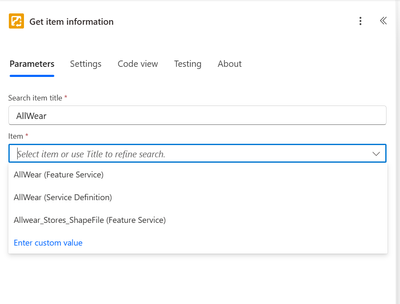

2025.2 introduces the “Get Item Information” action. This action retrieves all relevant metadata and details for a specific item from your portal, such as:
  • Title
  • Description
  • Comments
  • Number of views
  • Other key metadata
This makes it easier than ever to pull information about portal content for dashboards, reports, or automated documentation.
In the first parameter write the name of the Item you are trying to search and click the dropdown to find the relevant items.

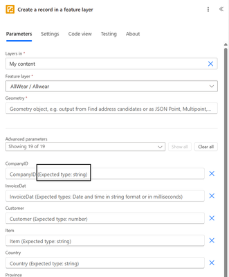

  • The expected field type for Create, Update, Read, and Delete actions are now clearly visible in the placeholder, reducing guesswork and errors in workflow configuration.
