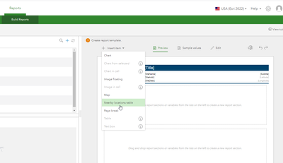

1. Build your own Business Locator report - Go to Reports > Build Reports to create your own report template. In the blank report, go to +Insert item and use the option for Neaby locations table.

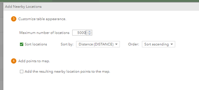

Go through the steps to create the Nearby locations table and when you reach step 3, you can cusomize the number of locations with a limit of 5000.
Once you have saved your report template, you can find it to run from a site under My reports.

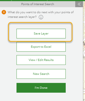

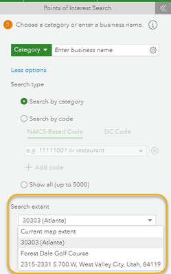

2. Use Points of Interest Search - Go to Create Maps > Points of Interest Search to explore business locations on the map with a limit of 5000 locations. This option also includes the point data for the locations and if you click More options, you can limit the search to your study area.
After displaying the locations, there is an option to Export to Excel
With this workflow, you can save the point data in a couple of ways :
  • Save the layer to your project contents. On the final step of the Points of Interest Search workflow, you will see an option to Save Layer. This will save the layer to your project so that you can use it again at any time.

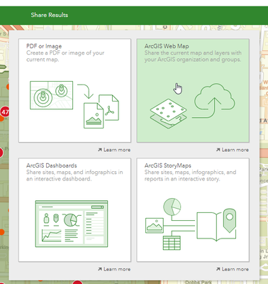

  • Share the web map and layer of business locations as an ArcGIS Web Map. When sharing the map, I recommended using the option to Export map layers in a new hosted feature layer for the most flexibility in using the point data.

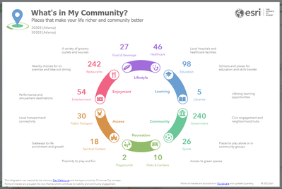

3. Infographics - We also have options through infographics for looking at Business Locations. There are 2 ready to use templates under Standard infographics for business locations - Eating Places/Nearby Restaurants and What's in My Community?. You can also create your own Nearby tables for infographics, similar to reports.
Help documenation for work with maps and Nearby tables in infographics
