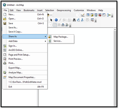

Hi, To show map in collector app may be you can try this option. when you share as a service
you have to go through several dialog box. Here, you find Feature Access option.
here, check mark on Create, Delete, Query, Sync, Update. and then follow rest of the dialog box. at the end click on publish button. Now, when you connect to portal in my content tab you see web layer. Open feature layer file and then open in Map Viewer and save this file. after that open collector app to collect data.
