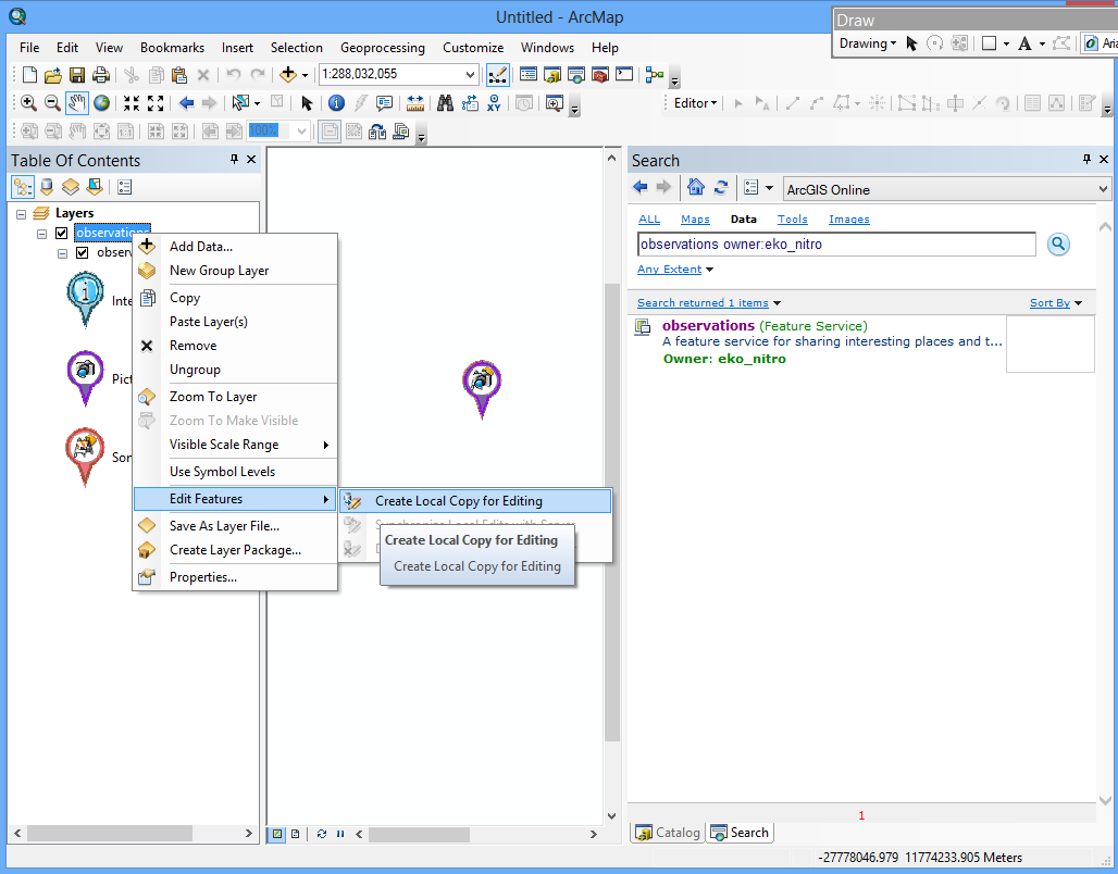

Using 10.2.2 I did the following.
In ArcMap using search I searched for the service that I am using with collector.
observations  owner:eko_nitro
I click to add it to ArcMap.
then Right click on "Group Layer" heading.
Edit Features  --> Create Local Copy for Editing

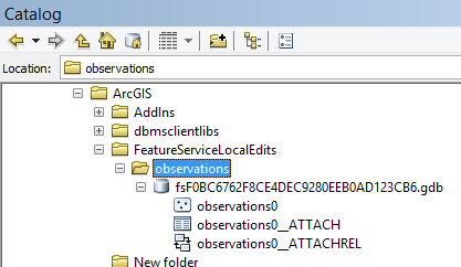

Looking at the Source for the observations layer it is updated with a local path.
and further verified by looking in Catalog.

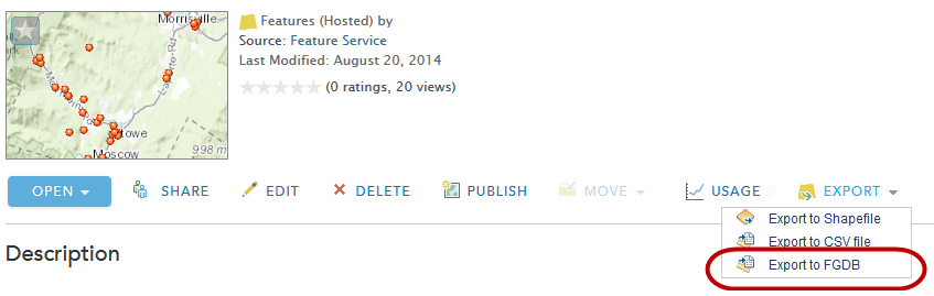

also if it is a hosted feature service on ArcGIS online and you own it, you can export it from ArcGIS Online.
