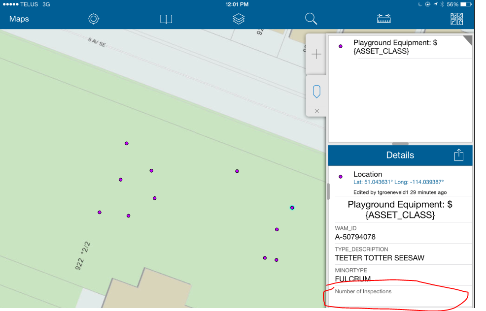

I have a map that I'm using in Collector for playground inspections.  Each piece of equipment needs to be inspected numerous times in a year.  Each inspection is stored in a related table.  For the popup on the playground equipment  I configured so that is displays the number of inspection using the statistic operator
This works as expected in AGOL
However in collector the field is always blank.  Is this not supported in Collector or have I sent up things incorrectly?

Currently the statistics operators are not supported in Collector.

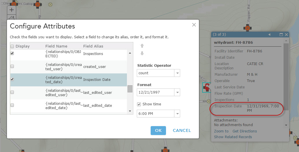

I've searched around and this is the most closely related thread I can find. I have the same set up as the original poster, namely 1-n inspections. If i set the popups to display the 'created_date' of a related record it simply defaults to "12/31/1969" regardless of the actual dates value...
