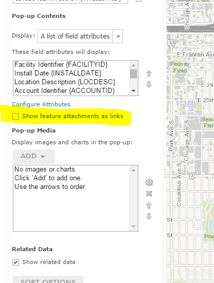

Hi. Geodatabase attachments are causing us big problems when syncing. As a workaround I want to prevent my users from viewing or editing attachments, and just download & sync features and related tables.
I can configure my web map layer's Pop-up to not "Show feature attachments as links". Then the "Show details" pane of a selected feature truly does not show the attachments. However, if I place a new feature or edit an existing feature Collector still allows me add attachments. And that's a problem because in my case any following Sync operations will fail.
How can I configure my ArcGIS Server Service and ArcGIS Online Web Map to prevent the addition of new attachments? (I can't delete all attachments, still need them in the geodatabase.)
