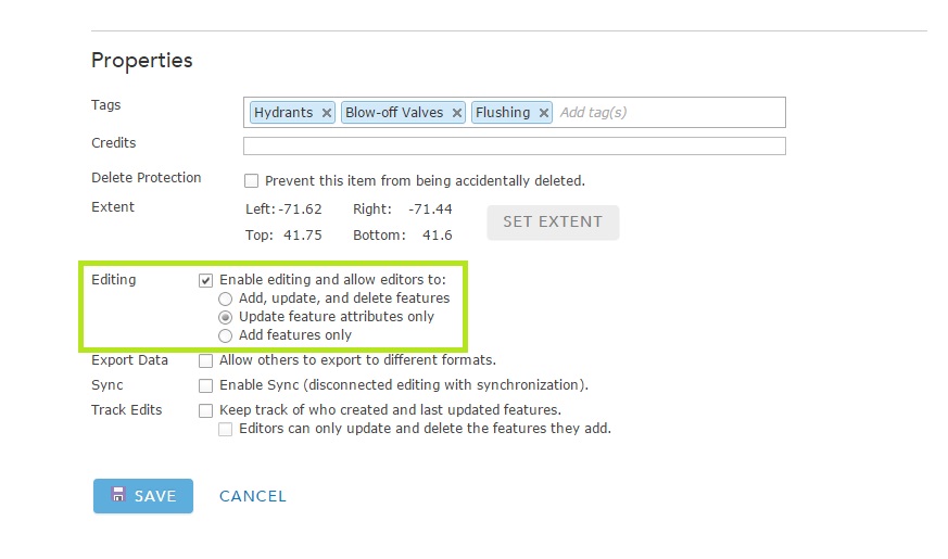

ShelbySouthworth
Deactivated User
If you click on the feature layer in "My Content" in ArcGIS Online, select "Edit", and scroll down to the bottom of the page. There you will find the "Properties" section of your layer, and as part of the "Editing" header there, you should select the second radio button reading "Update feature attributes only". This way your operators can select the hydrants without accidentally dragging them out of placeEditingOptions_AGOL.jpg
