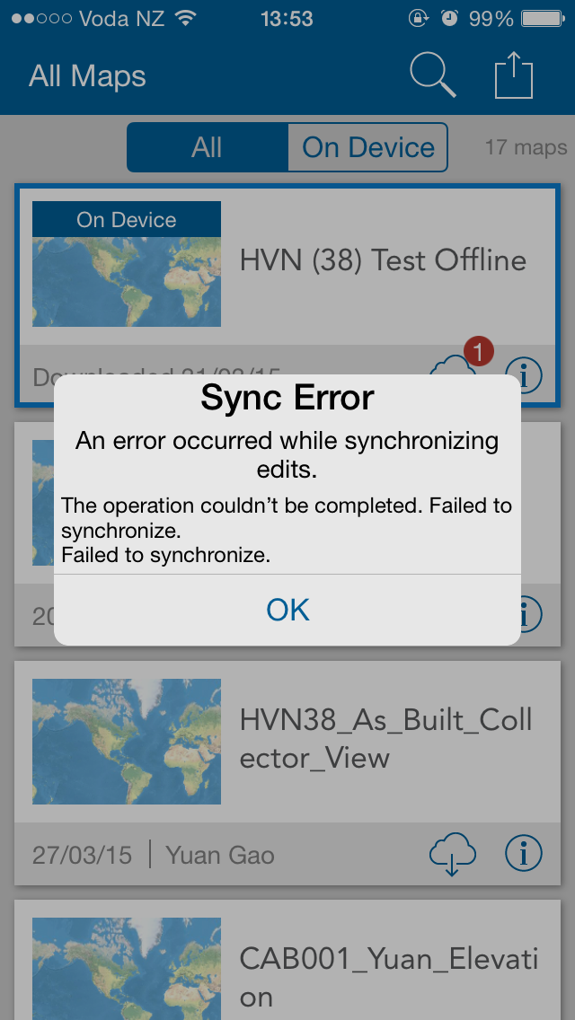

I have created a pointer feature class in geodatabase, published it via ArcGIS for Server, created a map in Portal and finally I managed to have the map working in offline mode.
However whenever I try to sync a feature that in created in offline mode, following error comes up, anyone know what's happening here?
Feature class properties
- Point feature
- attributes are: Note (200 character text), SHAPE, GlobalID,OBJECTID
- Archiving enabled
- Global ID added
Cheers
Yuan

Just a quick update, I found what was causing the issue.
It had to do of the naming of the service.
Originally I had: AsBuilt_Editable_Feature_Service_Note which didn't work, then I changed it to AsBuilt_Note, everything works just fine.
