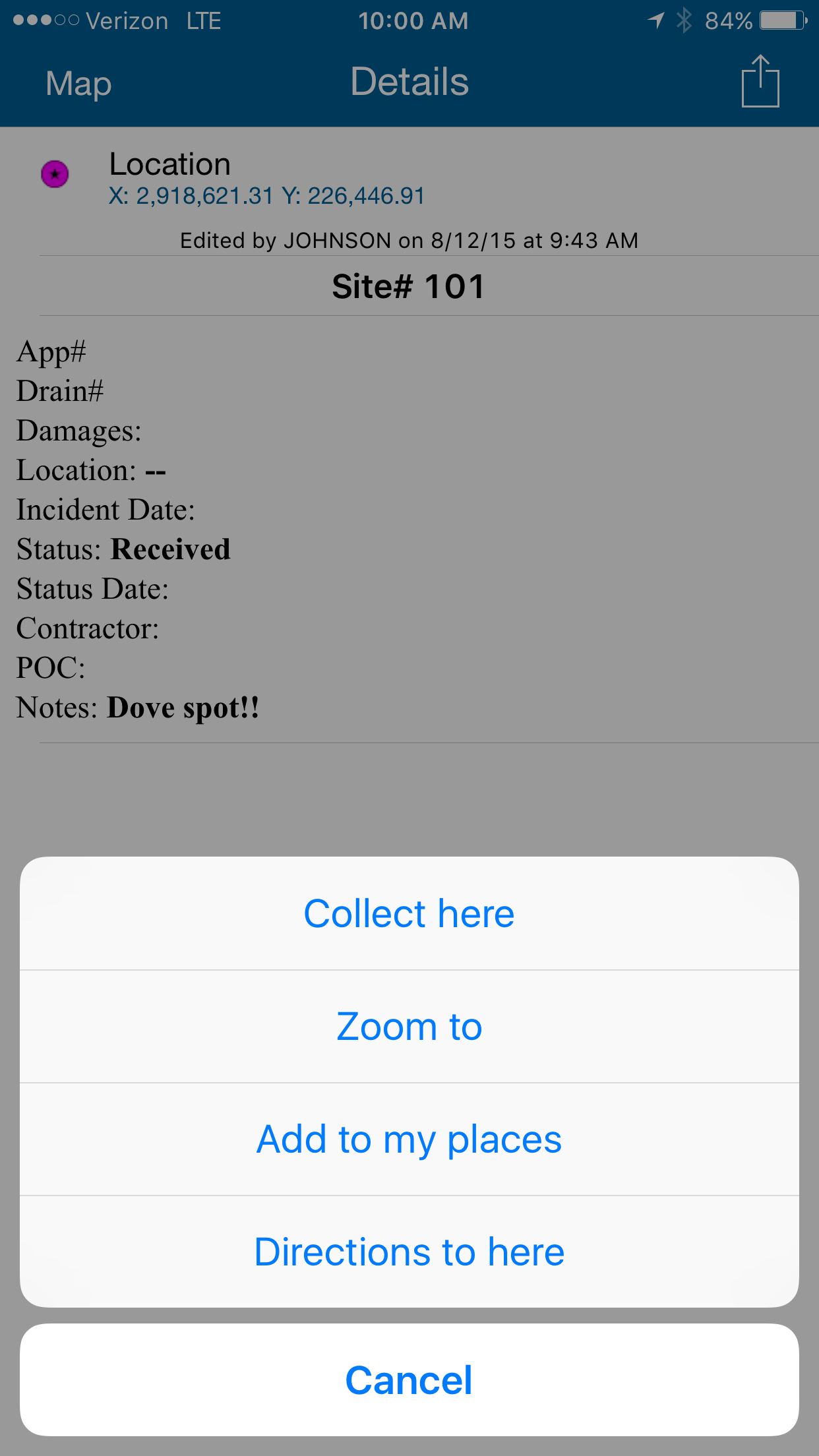

Has anyone had any problems with version 10.3.5 of Collector (released on October 18th)?  Since the update we have not had the ability to edit existing features.  We are using a portal based service with feature access.  It will allow us to add new points, but not edit existing points.  We have tried everything but are stumped.  In the portal we are able to edit and add points as always, so permissions is not the issue.
Below you can see a screen shot.  When you select a point, then click on the upper right button it gives this menu.  There used to be an option to edit it here, but it does not show up any more. Help!!!

This is now resolved.  I still do not know why the feature service that was working fine stopped working, BUT I took the same MXD file I used to create that service and created a new one.  O then created a new map for the new service and shared it appropriately.  The feature service is now editable.
