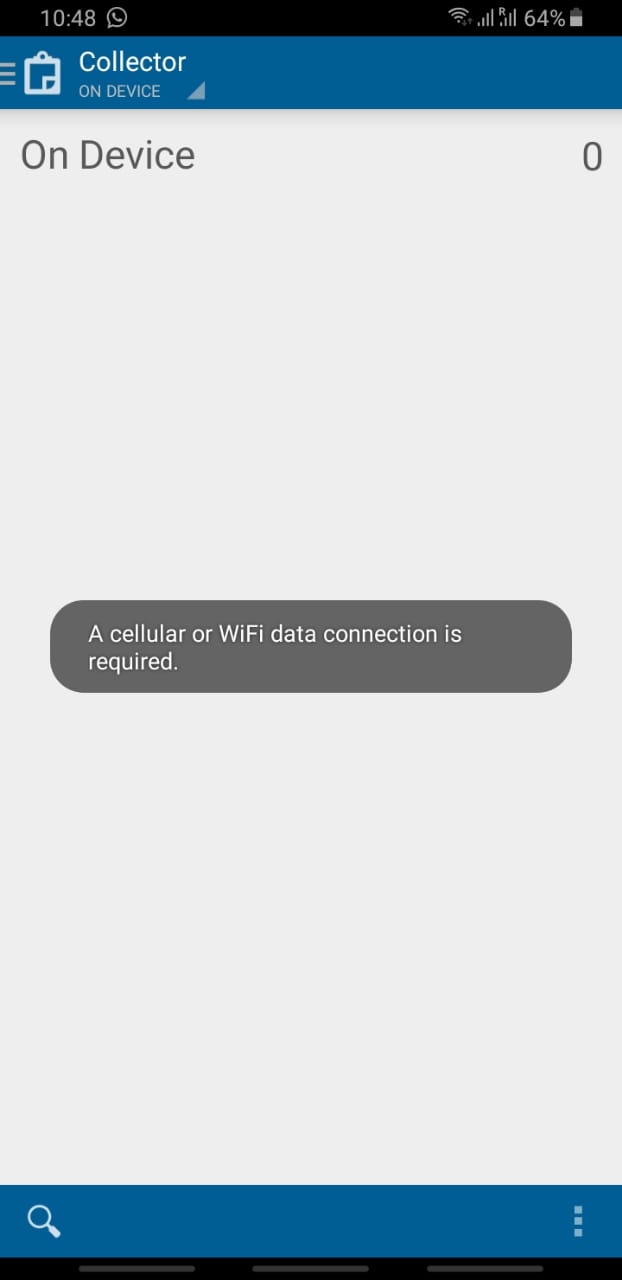

I cannot see my AGOL webmaps in Collector. These appear for a second and then the tab changes to "On Device" maps. When I change the tab back to "All "  a message appears " cellular or data connection is required". Surprisingly all these maps are visible in Collector Beta.
Q3) When you're attempting to access all of your web maps, are you connected online? Can you please check?

A3. Yes, on my office WiFi. I am absolutely sure because all other apps are working and even my maps are working in Collector Beta.

In my account the maps appear for a split second and then disappear. Display changes to "On Device". I change it manually to "All" and a message pops up "A cellular or WiFi data connection is required" and display changes back to "On Device"

We resolved it. There was a feature service with a local coordinate system in my AGOL. This coordinate system is not yet included in Collector but it is there in Collector Beta. Strange thing is that even after deleting the webmap collector would not work. It started working only after feature service was deleted.
