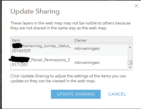

4). I have tried to turn off all of the sharing for the feature services individually and within the map without success. The strange thing is that I am asked to update the sharing of layers that are not shared the in the same fashion, when I click yes to all, it continuously loops through wanting to update the sharing?
