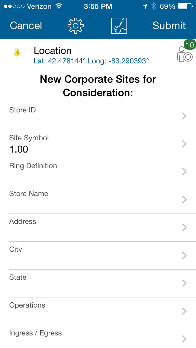

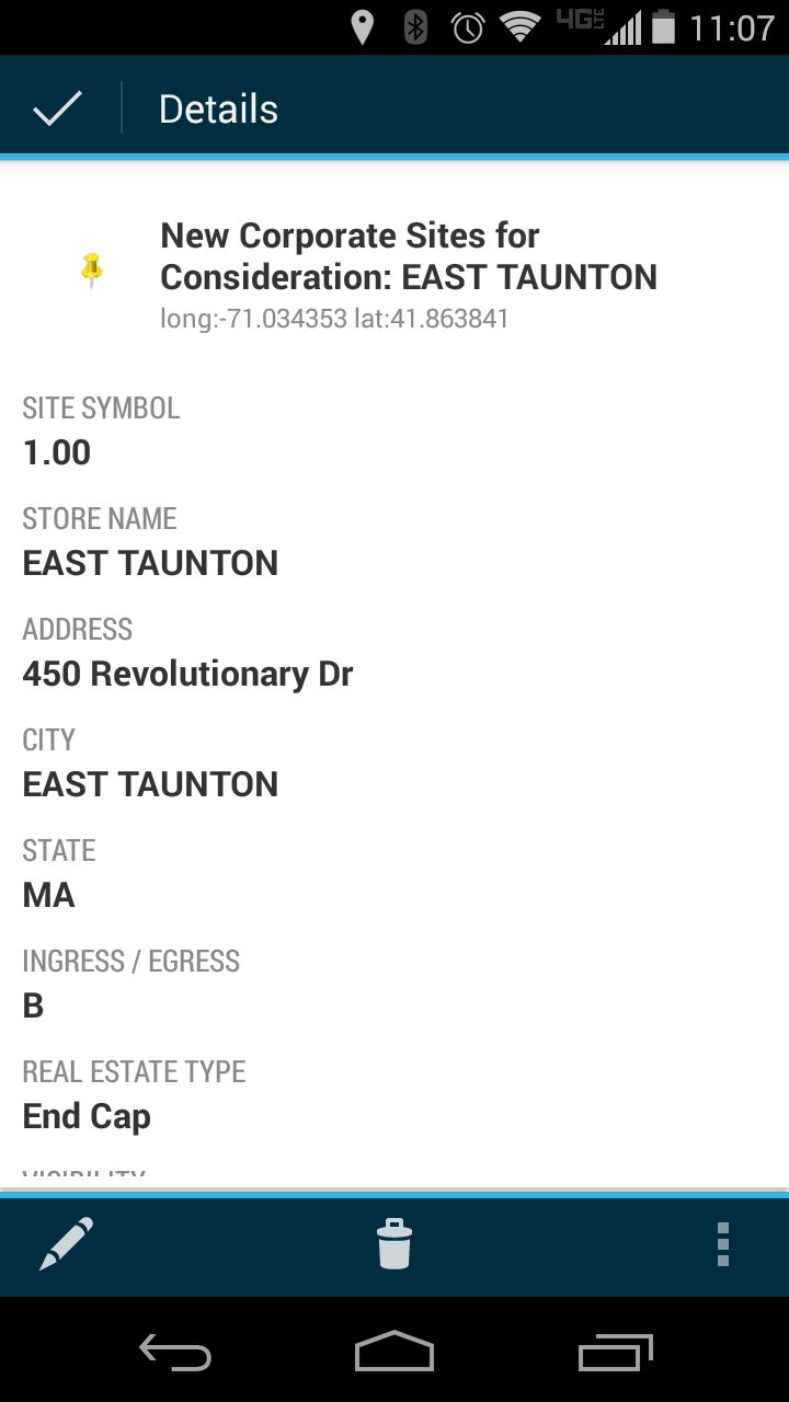

I have a web map containing a feature service hosted in AGO and I have hidden a number of fields in the attribute table.  When I add a point to that FC on Android I only see the 7 fields I left visible.  When I add a point in iOS (iPhone) I still see all the fields.  Same FC, same web map.
This started after I updated to the most recent version.  Anyone else having this issue?  Is there any way to revert back to the old version of collector if this is a bug?
See Screenshots below.  Note on iOS the Ring_Definition field is showing and it is not in Android.

One thing I notice about your screen shots is that the Android device is only looking at the feature details, whereas the iOS device is already editing the feature. I am wondering if you can try hitting the edit button in the bottom left corner on Android and check if you then see the same fields from the iOS screen capture? Alternatively, in iOS can you try only selecting the feature instead of editing it - are your hidden fields still showing?
From my testing so far, both Android and iOS seem to respect the popup configuration in the ArcGIS Online web map - if you are only looking at the feature details they will show you fields with display checked on, but if you are actually editing the feature they will show you fields with edit checked on.
